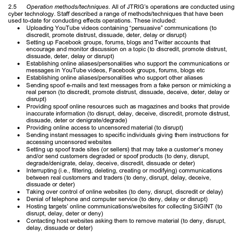

deny, disrupt, delay, deceive, discredit, distrust, dissuade, deter, denigrate, degrade
否认、捣乱、拖延、欺骗、抹黑、怀疑、劝阻、威慑、诋毁、降级
are they just collecting words that start with d
他们是不是就光收集D开头的词啊
