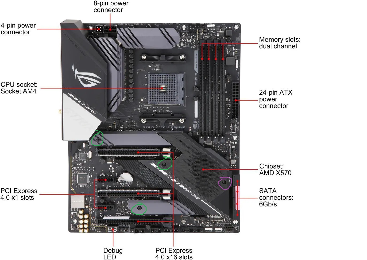

#1 STRIPPED SCREW
Anonymous · 2026-08-01 18:00
>bought a computer
>买了台电脑
>want to install second NVME
>想装第二块NVME
>the last screw holding the cover hiding the NVME is impossible to open
>盖住NVME的那个盖板最后一颗螺丝死活拧不开
>it's stripped
>滑丝了
>tried rubber band method and failed
>试过橡皮筋法,失败了
What do I do?
我该怎么办?
rog strix x570-e GAMING
玩家国度 ROG STRIX X570-E 游戏主板
The one I circled in purple is the one I can't get a grip of, the other ones I could remove just fine
我画紫色圈的那颗抓不住,其他几颗都能正常拆下来
图片: https://i.4cdn.org/g/1785607210459623.jpg

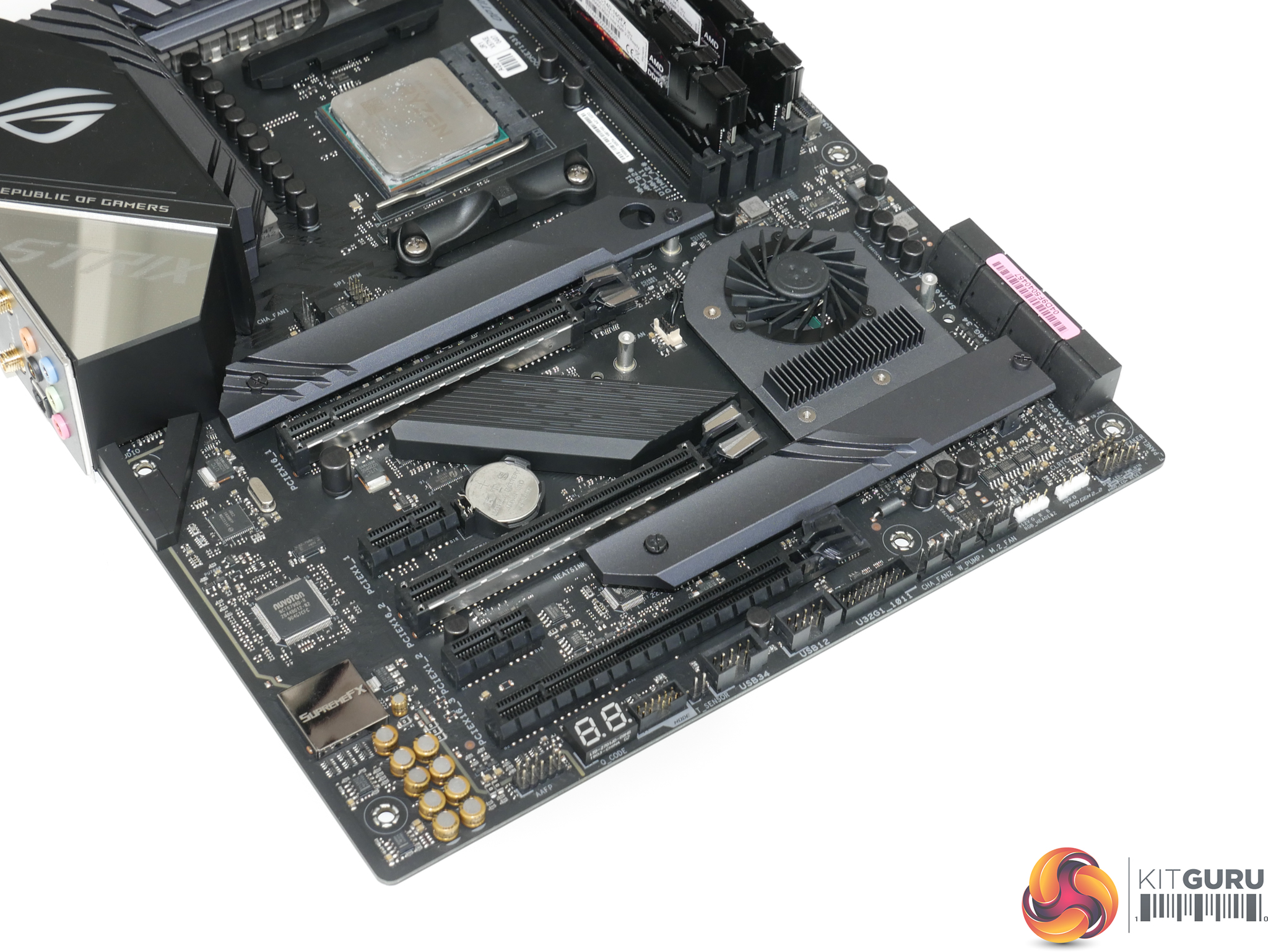

You get what you deserve. What a terrible fucking design to need to remove the PCH fan cover to access the M.2 slots.
你活该。这破设计简直离谱,非要拆掉PCH风扇盖才能碰M.2插槽。

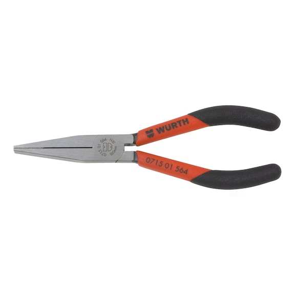

use pic related
用图里这个。
Works for me. Just need to grab it with a decent amount of power and then very slowly turn.
对我来说挺好用。只要用足够的力夹住,然后非常慢地转。

>>109431994
On that board it's just a cover plate, the actual heat sink is that tiny ass bitch next to the screecher fan. The green bit you can see through the fan blades is the chipset substrate.
那块板上那只是个盖板,真正的散热片是尖叫风扇旁边那个小不点儿。透过风扇叶片能看到的绿色部分就是芯片组基板。
