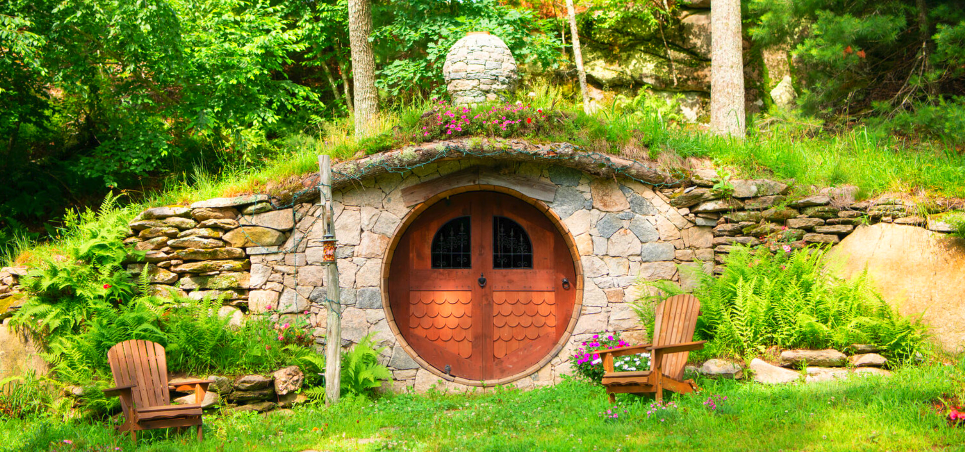

↳ #2 No.109478271
Anonymous · 2026-08-06 13:29
Why do hobbits prefer adirondack chairs?
为啥霍比特人偏爱阿迪朗达克椅?
Are they from New York?
他们是纽约来的吗?

>>109478271
No, that's just where they vacation, they live in New Jersey.
不,那只是他们度假的地方,他们住新泽西。

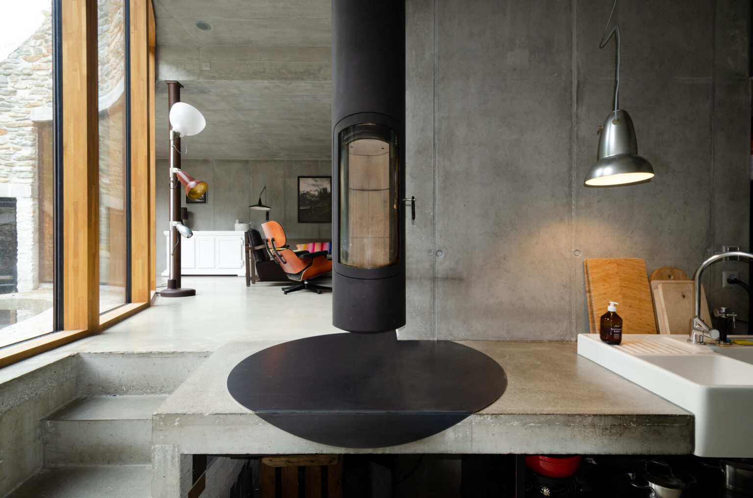

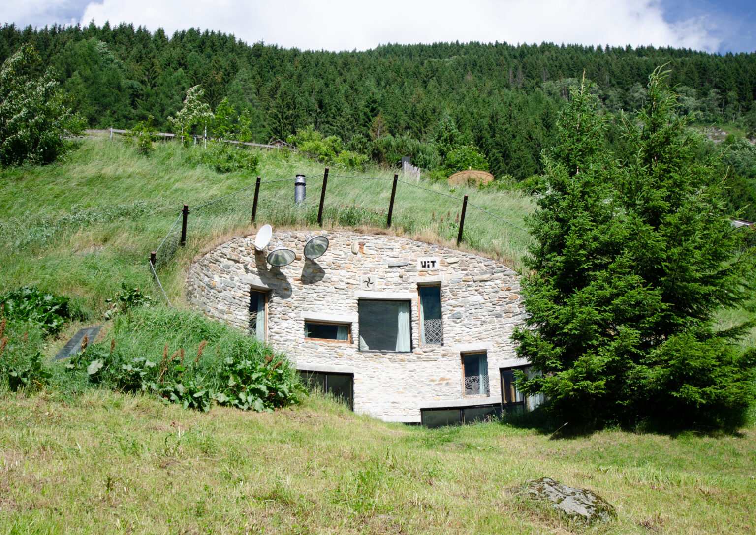

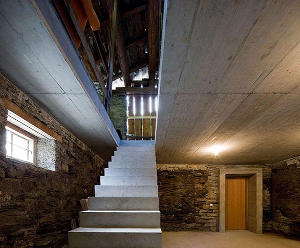

Without skilled builders you'll just have extreme levels of moisture plus more insulation issues.
没有熟练的工匠,你只会面临极端湿度和更多保温问题。
Even in Switzerland where some of the practical houses like this stand (not least because of the underground shelter and tunnel construction experience) it's still typically easiest to construct by removing the soil and then re-adding it, probably doesn't even cost much less than adding another floor.
即使在瑞士,那里确实有一些这种实用性住宅(很大程度上得益于地下掩体和隧道施工经验),建造时通常也还是先挖土再回填最简单,而且成本未必比加盖一层楼低多少。
You pay for the architectural statement.
你为建筑美学买单。
图片: https://i.4cdn.org/g/1786052850151515.jpg

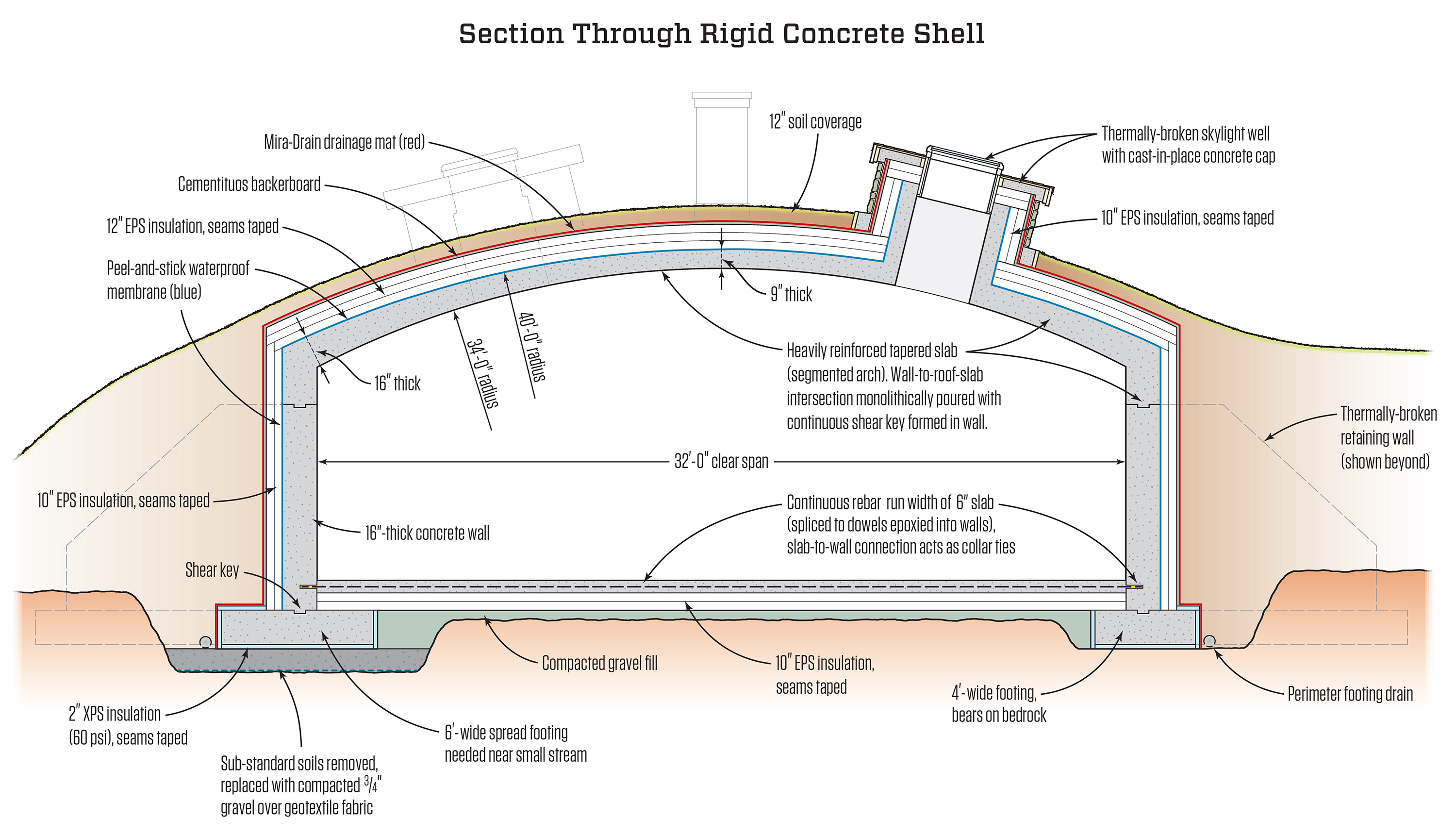

Look into monolithic domes. They work pretty well for earth-bermed and underground housing. But the real issue they're not as popular is because:
去看看整体穹顶结构。它们用于覆土和地下住宅效果很好。但真正的问题是它们没那么流行,原因有三:
1. Higher upfront cost
1. 前期成本更高 ⟦ 2. 穹顶的圆边要求更聪明的室内设计(虽然矩形结构没这问题,但矩形结构在承重和强度上不如穹顶,所以我不把它们视为地下住宅的候选方案)
2. Domes require more intelligent interior design due to rounded edges (although this is not true for rectilinear structures, but those are not as strong and good at bearing loads as domes are, so I am not considering them as candidates for underground housing)
穹顶因圆润边缘需要更精巧的室内设计(虽然直线结构不在此列,但它们的强度和承重能力不如穹顶,所以我不把直线结构列为地下住宅的候选方案)。
3. Ostracization. Being seen as the "weirdo" who lives in a home that's different from what most people have is not something the average person can either handle let alone wants. Most people prefer what is convenient and "normal" over what is functional and different
3. 被边缘化。被视为住在和别人不一样的房子里的“怪人”,普通人既招架不住也不想要。大多数人在乎的是方便和“正常”,而不是实用和与众不同。
I want a monolithic dome myself, since I think they're so functional, so I am obviously biased
我自己就想住整体穹顶,因为我觉得它太实用了,所以我显然有偏见。
Also absolutely do NOT do what >>109481768 says. I get that they're meming, but shipping containers do not have the structural strength needed to handle being buried underground and remain safe. You WILL get buried alive if you do this
另外千万别搞 >>109481768 说的那套。我知道他们在玩梗,但集装箱没有足够的结构强度来应付被埋在地下并保持安全。你要是这么干真会被活埋。

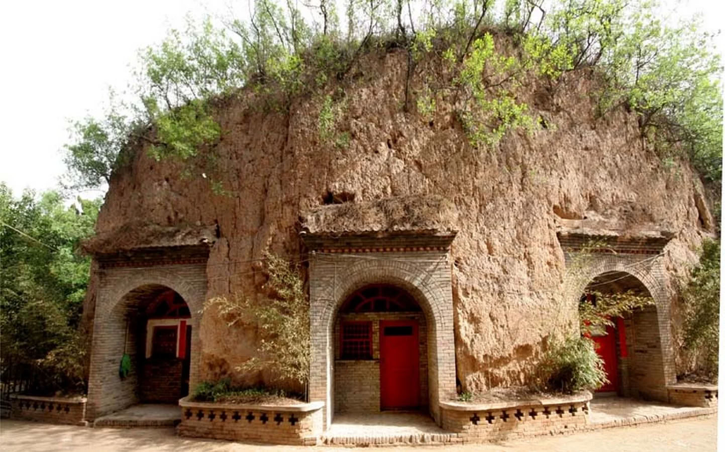

they are traditional in some parts of China
在中国一些地方这是传统做法。
google yaodong
谷歌搜“窑洞”。
