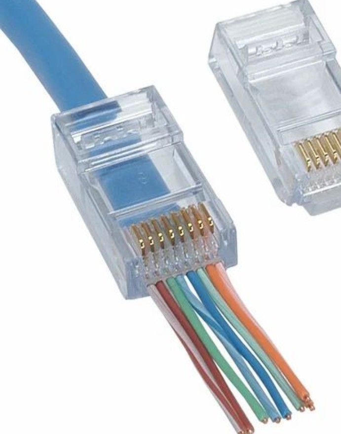

#1 Holy shit I just had to terminate a bunch of cat8 cable and that shit is fucking / 卧槽,我刚才得端接一大堆 Cat8 线缆,这玩意儿真他妈
Anonymous · 2026-07-24 22:05
Holy shit I just had to terminate a bunch of cat8 cable and that shit is fucking insane my fingers lost layers of skin and each individual cable gauge took crazy effort to pull through. I can't even imagine what cat9 is like.
卧槽,我刚才得端接一大堆 Cat8 线缆,这玩意儿简直疯魔了,我的手指都磨掉好几层皮,每根细缆穿过去都要费老大的劲。我根本不敢想 Cat9 会是什么样。
图片: https://i.4cdn.org/g/1784930732847630.jpg

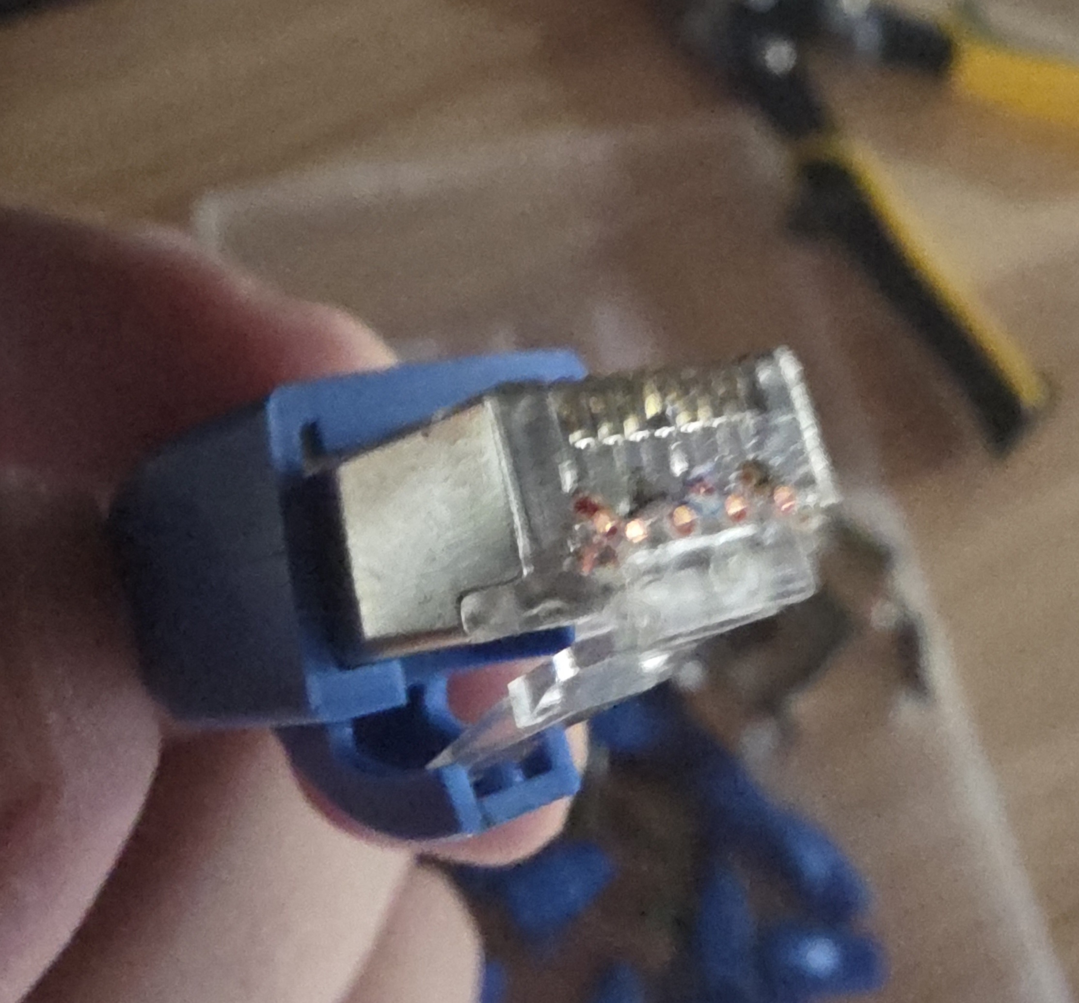

The protruding cable thing is so fucking real, here is one of the (many) failures.
线头露出来的问题太真实了,这是众多失败案例中的一个。
图片: https://i.4cdn.org/g/1784932119638426.jpg

>>109362892
>shielded plug
>屏蔽插头
oof
哎哟
if you don't actually need the shielding it's easier (less tool dependent) to use the regular plugs
如果你实际上不需要屏蔽,用普通插头更省事(不怎么依赖特殊工具)

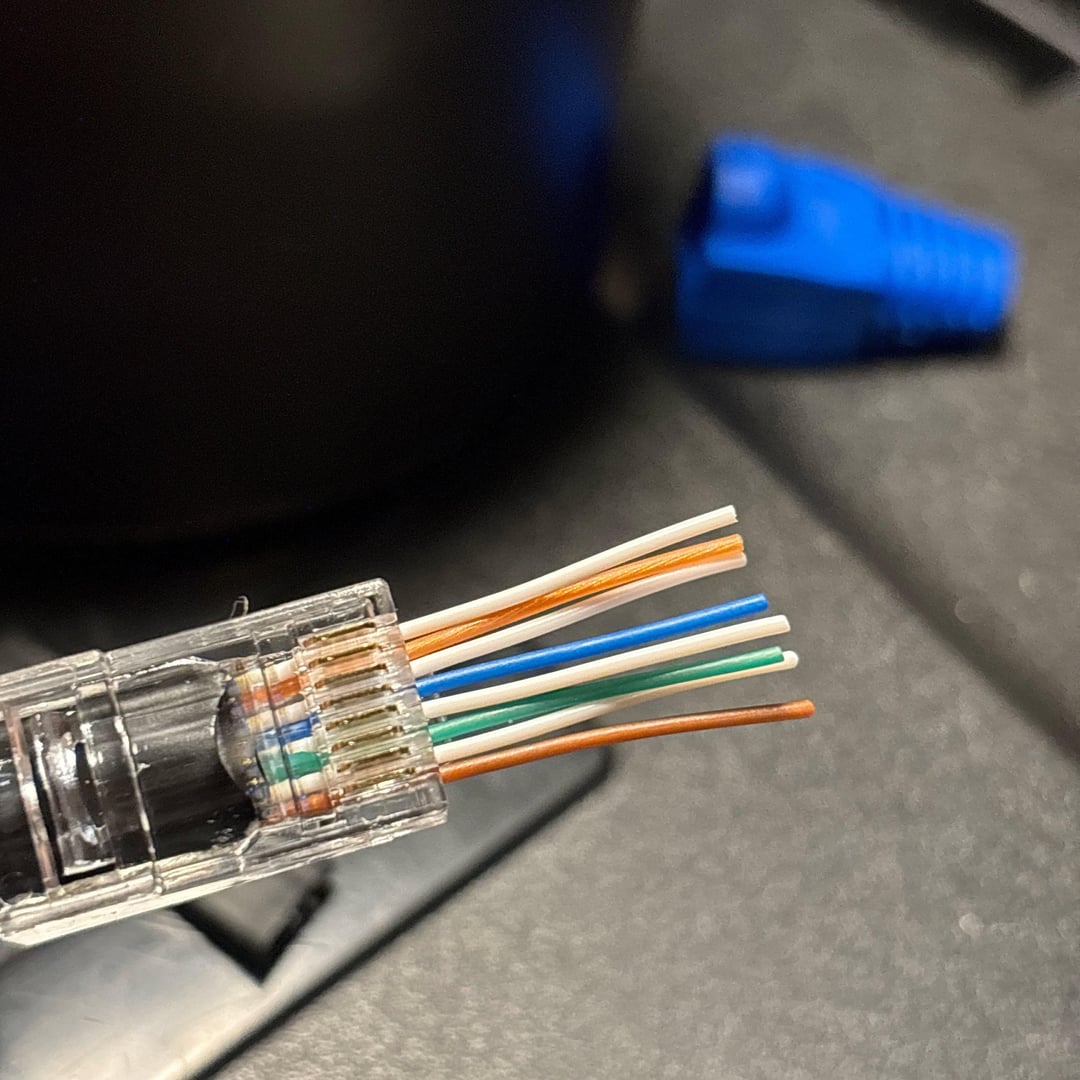

图片: https://i.4cdn.org/g/1784941587664945.jpg

>>109363809
Anon, your browns are flipped. Now, the bits won't care as long as you fucked it up the same way on both ends (they're in the same twisted pair, after all), but solid brown should be on the outside.
匿名者,你的棕色线接反了。现在,只要你在两端都以同样的方式搞砸了(毕竟它们在同一个双绞线对中),比特们也不会介意,但实心的棕色线应该在外层。
图片: https://i.4cdn.org/g/1784972630592850.jpg
