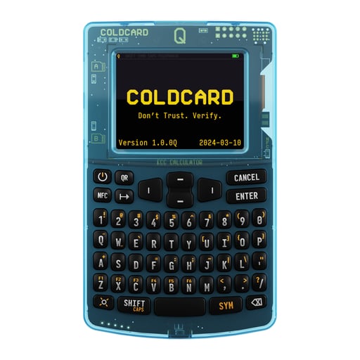

#1 >use hardware wallet / >用硬件钱包
Anonymous · 2026-08-01 08:25
>use hardware wallet
>用硬件钱包
>still get hacked
>照样被黑
So where exactly are you supposed to hold your buttcoins?
那你的屁股币到底该放哪儿?

I only remember this piece of shit from ads I saw years ago. no one ever talked about it. now we see why
我就是几年前从广告里记住这垃圾货的。从来没人讨论它。现在知道为啥了。
↳ #13 No.62549938
Anonymous · 2026-08-01 16:33
Rolling for inside job. Thankfully, I rolled dice but I still transferred the funds off my Q this morning.
押注有内鬼。还好我掷了骰子,但今早我还是把资金从我的Q上转走了。

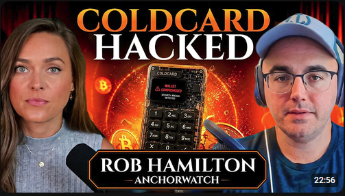

Coldcard literally wasn't. Its RNG seed generation was flawed and now people can find working seeds in like 5-10 seconds with AI.
Coldcard显然不是。它的RNG种子生成有缺陷,现在人用AI大概5-10秒就能找出有效种子。

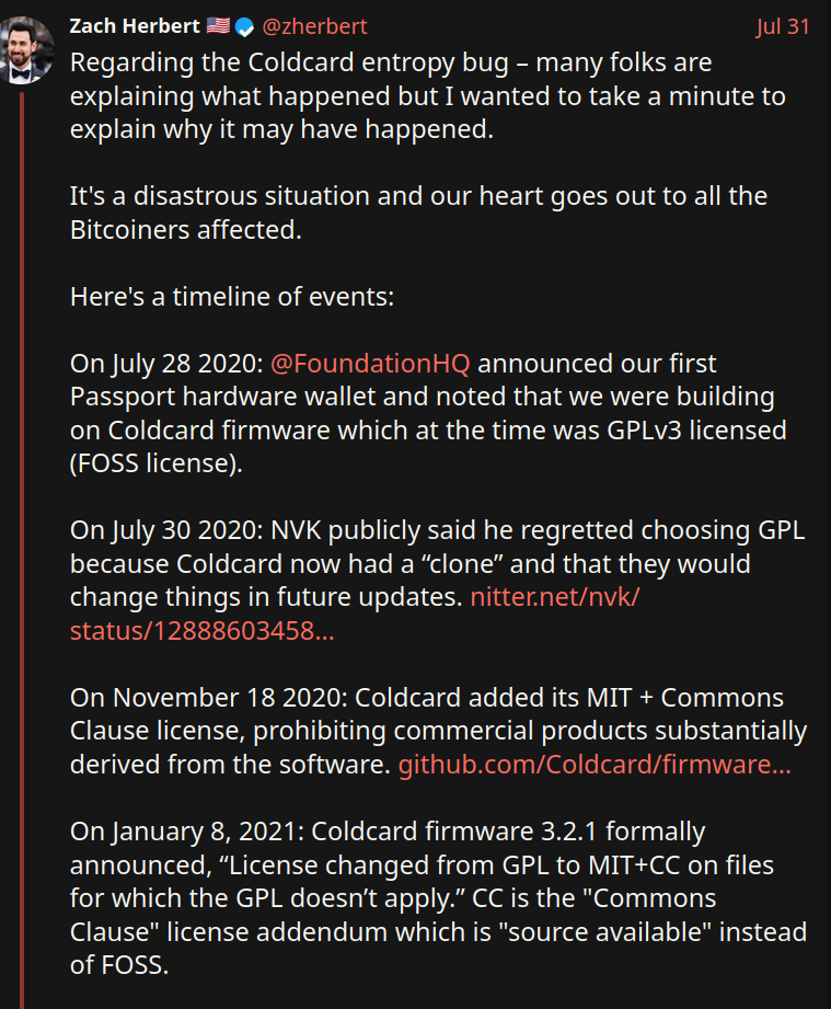

Coldcard was not open source. Nobody is allowed to use the source code for new projects. There's no point for anyone to review the code. The bug literally got introduced and stayed there ever since they removed all GPL code dependencies.
Coldcard 不是开源的。没人可以用它的源码搞新项目。没人有必要去审查代码。这个漏洞就是被引入后一直留着,从他们移除所有 GPL 代码依赖开始就没动过。
Continuation of tweet:
推文续:
Our best understanding right now is that the entropy bug was collateral damage from this major overhaul of the codebase.
我们目前最好的理解是,熵漏洞是这次重大代码库重构的附带损伤。
To be clear, this overhaul was not solely about licensing. Coldcard also cited technical goals including adopting Bitcoin Core’s libsecp256k1, faster AES and SHA implementations, and reproducible builds.
需要说清楚,这次重构不单纯是许可问题。Coldcard 也提到了技术目标,包括采用 Bitcoin Core 的 libsecp256k1、更快的 AES 和 SHA 实现,以及可重现构建。
But the timeline establishes two things:
但时间线证明了两件事:
(1) Foundation’s launch was the obvious impetus for Coldcard’s licensing change, and
(1)Foundation 的推出显然是 Coldcard 改许可的直接推动力,而且
(2) removing the remaining GPL code was an explicit goal of the subsequent v4 rewrite.
(2)移除剩余的 GPL 代码是后续 v4 重写的明确目标。
We don't know by how much the licensing pressure affected the scope or timeline of the rewrite. All we can determine is that the entropy bug was introduced inside the same 120-file commit that removed the old GPL code dependencies.
我们不知道许可压力对重写的范围和时间线影响了多少。我们能确定的只是,熵漏洞是在同一个移除旧 GPL 代码依赖的 120 文件提交里被引入的。

it was cold storage you could have done everything right, but it only generated a few different seeds so anyone can guess them, and now people are guessing multi-sigs and 25th words which take more time to crack.
那是冷存储,你其他什么都做对了,但它只生成了少数几个不同的种子,所以任何人都能猜出来,而现在人们在猜多签和第25个词,那些破解起来更费时间。
It's a free for all 1,000s of BTC are being stolen right out of safety deposit boxes with zero access all because of a non random seed generator.
这就是一场混战,数千枚 BTC 正在从完全无法接触的保险箱里被偷走,全都因为一个非随机的种子生成器。
